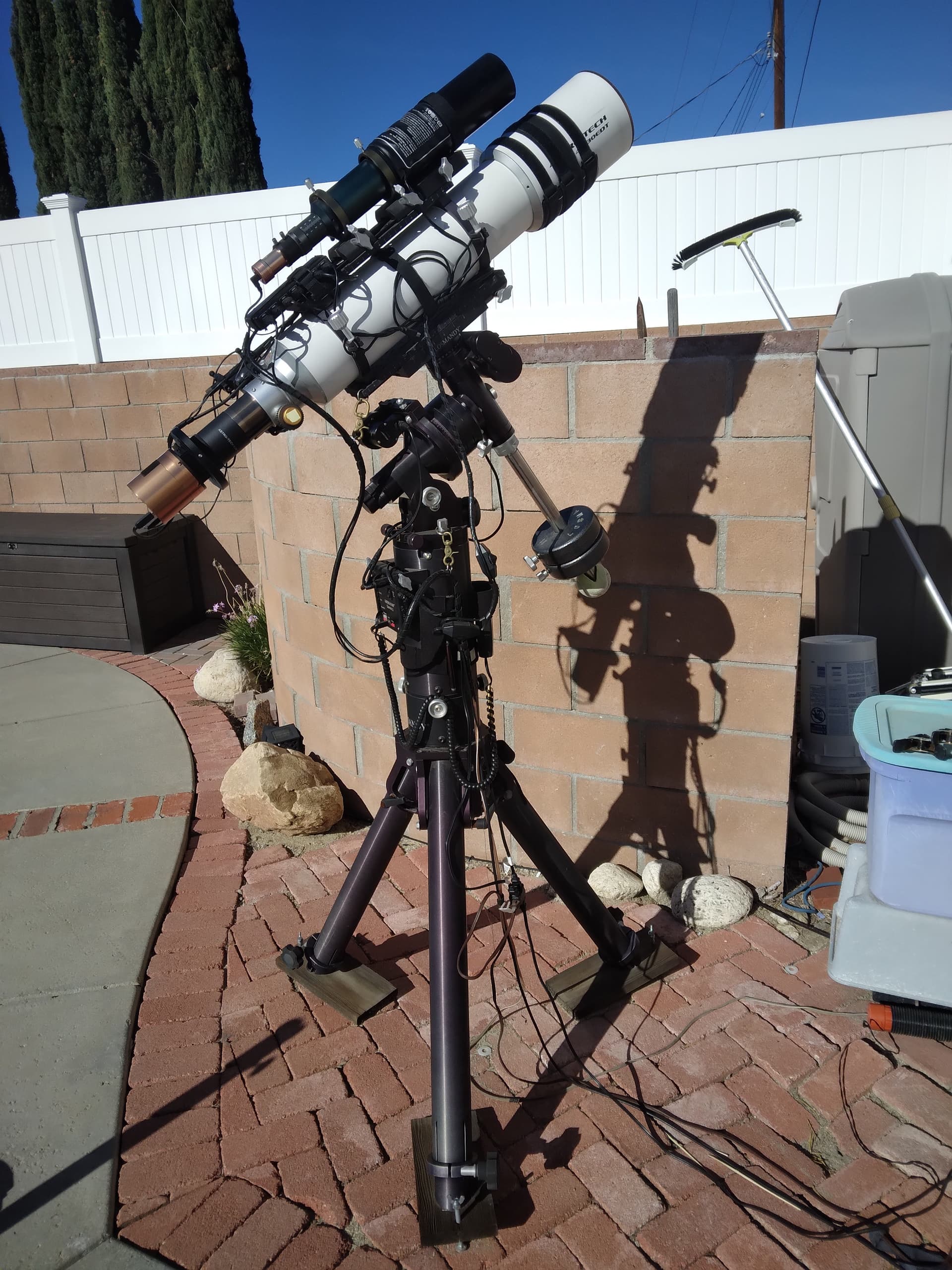

I donno. Maybe my dew shield for my Guide Scope, or my redwood feet for my tripod.
Last year I got dewed out one evening when my guide scope fogged up with dew. I made my own dew shield for my Svbony 106 60mm guide scope out of 3" black PVC pipe and a clamp for my Losmandy D-bar I use on top of my AT130EDT telescope. I added a heating pad to it to insure it won’t dew up.
My redwood feet for my Losmandy GM811G mount are fitted with bolts to adjust the height to plumb my mount to the Earth where I keep it set up. I level my mount with my digital level, so my mount is plumb to the Earth and has a level starting point.
They can be seen under my mount’s feet in the above image.
Since we bought this house with a pool, I used to use a 5-gallon bucket hung under my AVX mount to dampen it. I would dip pool water in it for ballast.
That’s a few of my home groan modifications. I’ve always been a DIY guy…
