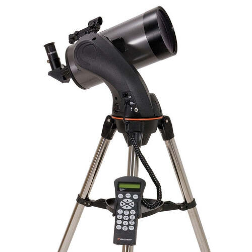

Celestron Astro Fi 102mm Computerized Telescope
https://www.amazon.com/Celestron-Maksutov-Reflecting-Telescope-22202/dp/B01L0EQLTI?th=1
The Sky-Watcher caught my attention because of the larger 150mm aperture, GoTo tracking, and smartphone control. The Celestron Astro Fi 102 looks more compact and portable, and Space.com specifically recommends it as a beginner-friendly motorized GoTo telescope.

The 102 Mak will be easier to use but the glass on the front will be a dew magnet. Also 4 inches isnt real big and it doesnt gather a ton of light.
